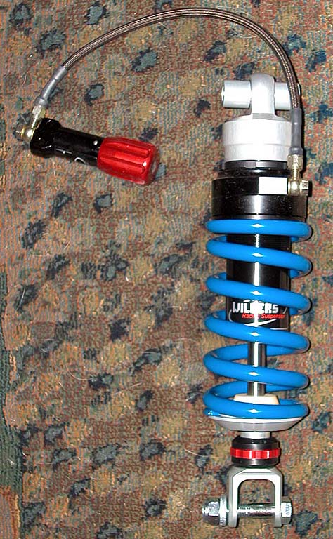

    3. Not a "required thing to get it ready to ride" as I could have gone
    for a ride any time before I stated taking things apart. At 26,000 miles
    the suspenders were getting worn and needed replacing. I went with
    custom fit Wilbers front and back. (http://www.wilbersusa.com/)
    Specifically the 640 with remote preload adjuster in the back
    (http://www.bikes-n-spikes.org/mods/susp/wilbers01.jpg)
    4. Having an adjustable suspension means that you adjust it for your
    specific requirements (which is what I was describing in the original
    post) after installing the new suspension).
